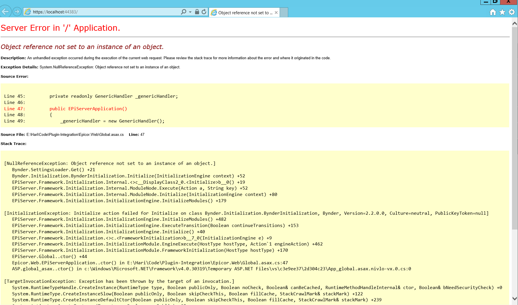

We are trying to Install/Integrate Bynder DAM into Opitmizely CMS, after installation of nuget package I'm getting below error.
Can you please let me if any one experenced the same issue and if any other suggestions/workarounds.?

Tha bove issue got resolved after adding the Bynder AppSetings in the web.config.
Configure these AppSettings:
Bynder:BaseUrl - your bynder portal url
Bynder:ClientId from the Bynder portal
Bynder:ClientSecret from the Bynder portal
Bynder:AutomaticMigration with the value true to automatically create the tables needed. If missing you
need to manually run the tools\create-*.sql to create the tables needed.
Yes It was bit strange, not clear error.
However the above configs works.
