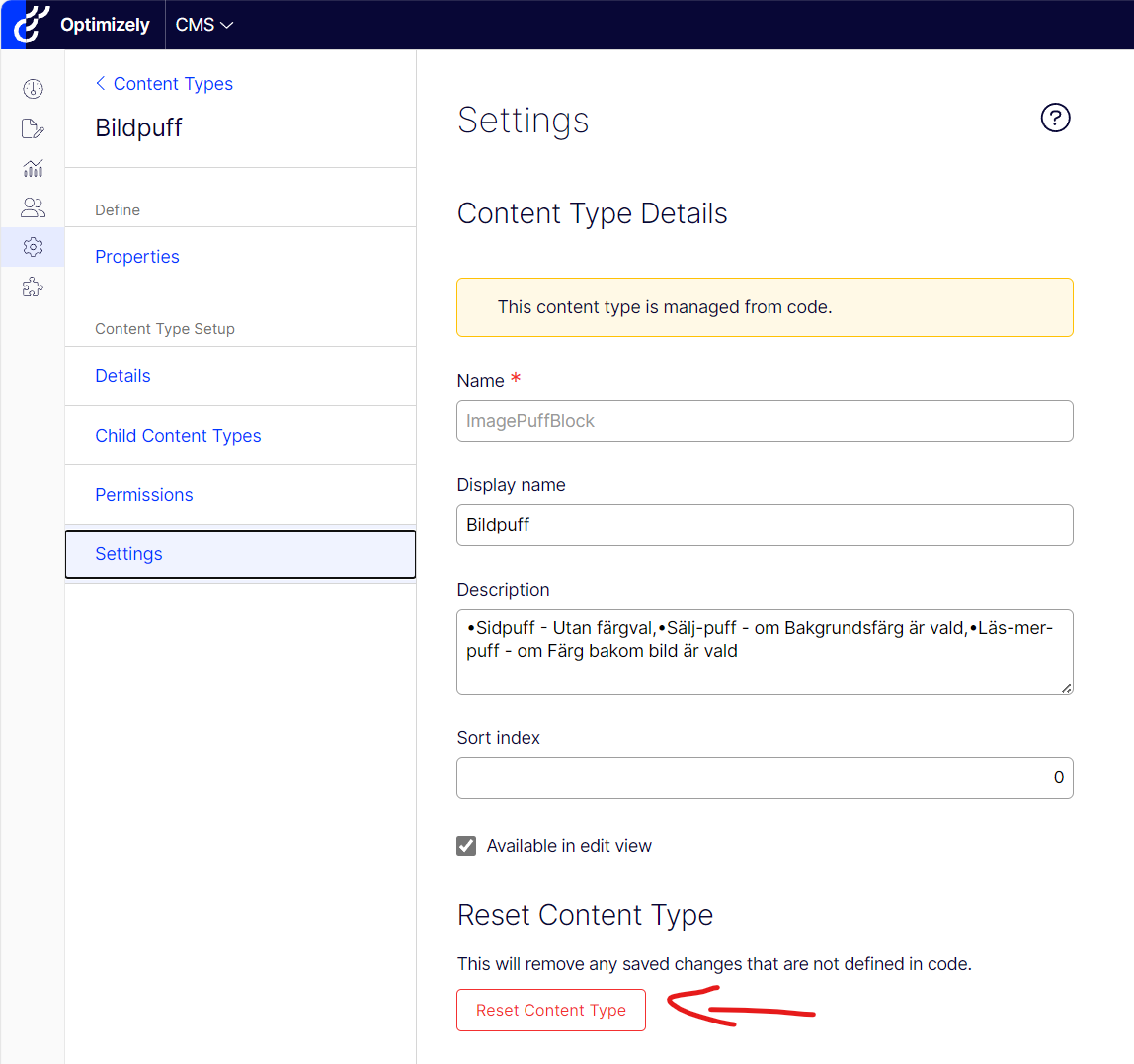

You will probably have to reset the content type in the [CMS > Admin > Content Types] section

Thanks Eric, That worked partially. Still I'm seeing that overrided property name is not appearing in the CMS, that means I have a virtual property in parent class and in the child class I'm updating the name to different one, like Parent(Name= A) -> Child (Name=B), Its not working.
