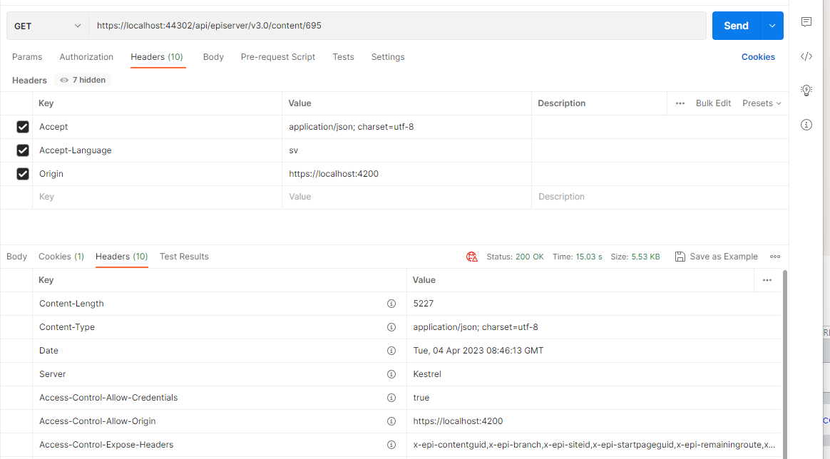

Content Delivery Api Request example

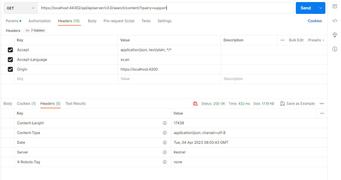

Content Search API Request example

Was able to solve this using a default cors policy which the search api uses.
 services.AddCors(options =>
                options.AddPolicy(
                    this._contentDeliveryApiCorsPolicy,
                    builder =>
                        builder
                            .WithOrigins(webConfiguration.ContentDeliveryAllowedOrigins.ToArray())
                            .WithExposedContentDeliveryApiHeaders()
                            .AllowAnyMethod()
                            .AllowAnyHeader()
                            .AllowCredentials();
                options.AddDefaultPolicy(
                    builder =>
                        builder
                            .AllowAnyMethod()
                            .AllowAnyHeader()
But there should really be a specific policy in the configuration like AddContentDeliveryApi uses.
