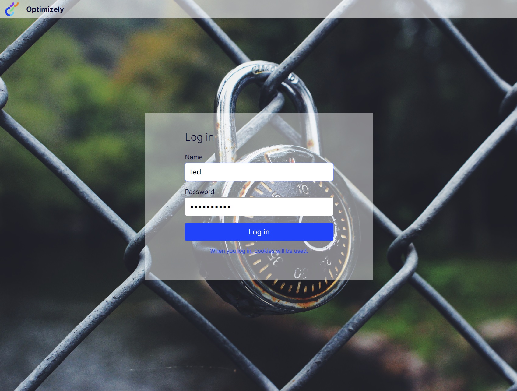

Can you change the background image in EpiServer 12 like you can on 11 and prior?
On 11 and prior you could do it like described here: https://world.optimizely.com/blogs/jacob-pretorius/dates/2019/8/quick-episerver-custom-login-background/ but I can't find any information on how to do it on EpiServer 12.

One idea could be some middleware like:
/// <summary>
/// Replaces the original login background image.
/// </summary>
public class LoginBackgroundMiddleware
    private readonly RequestDelegate _next;
    public LoginBackgroundMiddleware(RequestDelegate next)
        _next = next;
    public async Task InvokeAsync(HttpContext context)
        if (context.Request.Path.StartsWithSegments("/Util/images/login/login-background-image.png"))
            context.Response.Redirect("https://images.unsplash.com/photo-1509822929063-6b6cfc9b42f2");
        else
            await _next(context);
You'd add it to the Configure() method in Startup:
// Custom login background
app.UseMiddleware<LoginBackgroundMiddleware>();
Final result:

Hi Ted
That's an excellent proposal! I'll try it out.
Thank you!
