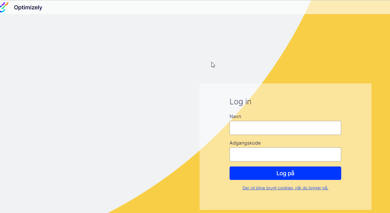

When I go to -> https://localhost:5001/util/login?ReturnUrl=%2fepiserver it just shows the normal login page and not our ADFS login page.
Any help would be appreciated

For your WS-Fed scheme to actually trigger a login flow, something need to do  challenge for that scheme. E.g. a 401 response. /util/login won't do that, since that view allows anonymous requests.
Why have you onfigured with a policy scheme? Do you intend to support multiple authentication schemes, i.e. "mixed mode"?
What happens if you configure default scheme and default challenge scheme to WsFederationAuthenticationDefaults.CookieName? Then try to access /episerver/cms. Does the correct login flow happen?
