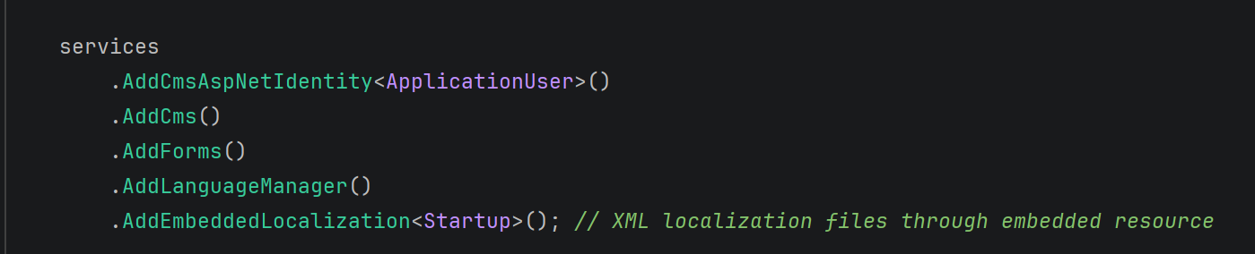

You know you can override this in an xml file for your own project, until it's fixed by Optimizely?
#343228
Aug 31, 2026 15:19
Its in this place you add it in startup.cs
