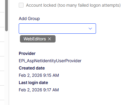

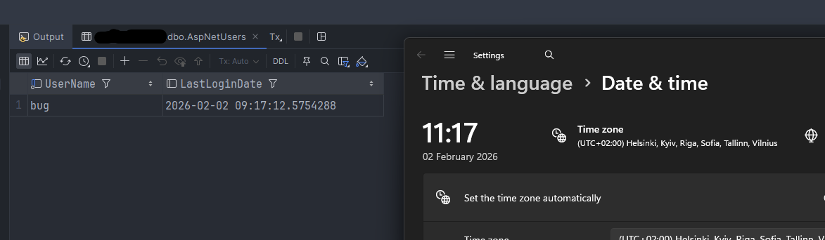

When user logs in, their last login date is saved to database as UTC time.
The issue is that their last login date is shown as UTC time in the CMS:

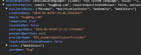

The bug seems to originate from "/EPiServer/EPiServer.Cms.UI.Admin/users/GetUser?userName=bug" API which subtracts 2 hours from the last login (suggesting that this API treats already UTC time as local time):

I can replicate this in local, test and production. Other projects also have this issue which suggests that this isn't project specific.
I've tried to change the timezone of the computer/server (and the db server), but that doesn't have any effect.

This is not related to database collation (SQL_Latin1_General_CP1_CI_AS) and changing server/database timezone will not fix it.
In Optimizely CMS, LastLoginDate is stored in UTC (correct). However, the /EPiServer/Cms.UI.Admin/users/GetUser endpoint returns the value after it has been converted using the server’s local DateTimeKind
If the stored value is already UTC but is treated as DateTimeKind.Local before serialization, .NET will apply an additional UTC conversion — resulting in the time shift (e.g., −2 hours depending on server timezone).
Workaround options:-
Intercept/override the admin API response and explicitly set:
DateTime.SpecifyKind(lastLoginDate, DateTimeKind.Utc)
Or convert explicitly before returning:
lastLoginDate = DateTime.SpecifyKind(lastLoginDate, DateTimeKind.Utc);
Alternatively, adjust in the UI layer if overriding the endpoint is not desirable.
This is essentially a double-conversion issue caused by DateTimeKind handling during serialization.
