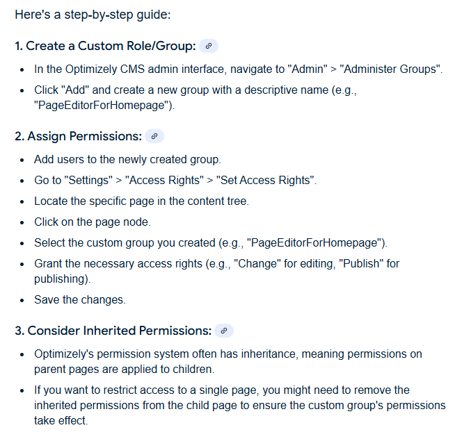

I'm trying to provide access to specific group of people for a particular page(News) and its child items, So I followed the below steps but its not enabling the edit access to user, meaning user is not getting the top right Epi Edit page link and mannual url login(/EPiServer/) also not working.
