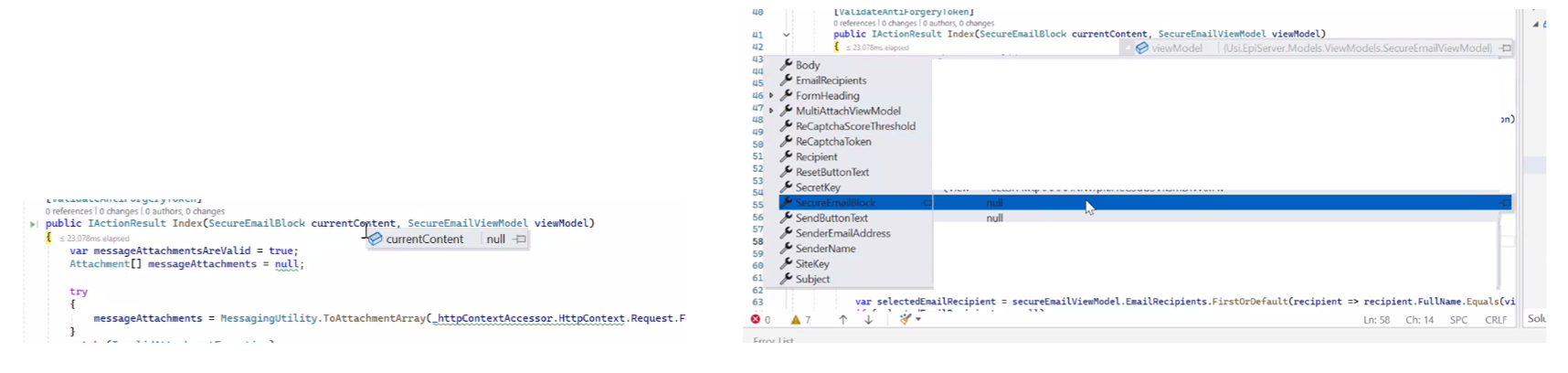

While the GET call for the Block Component works and the block loads as expected, the POST call does not work. My application has a few POST requests that is made via AJAX.
I understand that ViewComponents are primarily used for display purposes. However, I’m unsure how to handle post-back calls
with ViewComponents, as using IActionResult within ViewComponents does not seem to work. BlockControllers are no longer valid in Optimizely12 .As a result, I ended up using both ViewComponents for display and an MVC Controller for handling post-back calls.
Here are the issues I’ve encountered with this approach
1- When the AJAX call is fired, the block is null on the POST call.
2- Next, I switched to using just a ViewModel in the Controller instead of the block.
     The ViewModel has a content ID that I fetch in the GET call and pass in the form data from AJAX.This ID i include in VIewModel which gives me the block on POST method call as below:

However, this approach results in the block instance being different, causing model validation failures and issues with returning the view (return View("SecureEmailBlock", viewModel);).

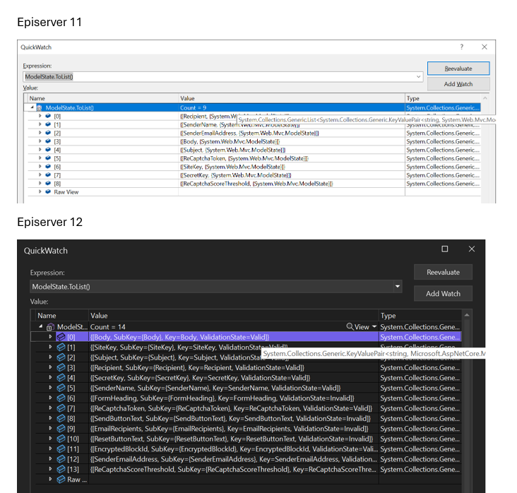

Additonal info on the Modal State from 11 vs 12

I’m curious about how Optimizely 12 handles POST requests because right now, the Model.IsValid check is failing since the block is empty. If I pass the Content ID in the model and assign it in the GET request (which is what I’m currently doing), then on the POST request, using the same ID to retrieve the block from the Content Repository causes the model validation to fail because the instance of the block is not the same.
I hope I’m making sense here.

No difference in the output when converting to BlockData instead of the specific Block Type. But the one difference that I see when comparing the same with 11 for ModelState is attached in the query above.
ZZ - Sep 18, 2024 15:18
But do you get exact block type ? You can insert breakpoints and see the output
ZZ - Sep 18, 2024 15:22
Try this when returning view ->
return View("~/Views/Shared/Blocks/Components/SecureEmailBlock/SecureEmailBlock.cshtml", secureEmailViewModel);
if this doesn't work then share some of html from SecureEmailBlock.cshtml
Farhin - Sep 18, 2024 15:23
Yes I do get the exact Block. Just needed conversion in GetSecureEmailViewModel
var secureEmailViewModel = GetSecureEmailViewModel(currentBlock, _contentRepository, _contentTypeRepository, viewModel);

Do you have got any particular line of code which is thorwing an error ?
Farhin - Sep 18, 2024 16:24
Model.IsValid is the first place where the validation fails.The other is return View() as it’s not able to relocate the view.I get that issue mentioned might be case by case scenario but
What I am really trying to know is how are post requests being handled in Optimizely12 since BlockControllers are obsolete in 12.
ZZ - Sep 19, 2024 7:26
Yes because your Model state is not valid. You have to look at the view model and compare it to the data sent from browseren. I have created all my POST requests in page controllers and not MVC controller. POST requests are part of MVC architecture.
https://learn.microsoft.com/en-us/aspnet/core/tutorials/first-mvc-app/controller-methods-views?view=aspnetcore-6.0
