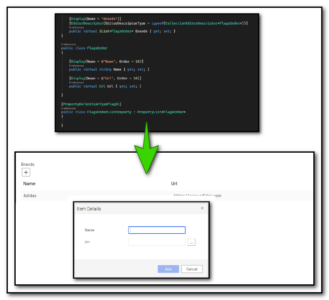

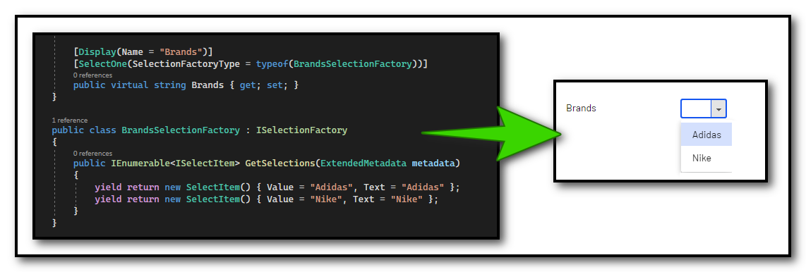

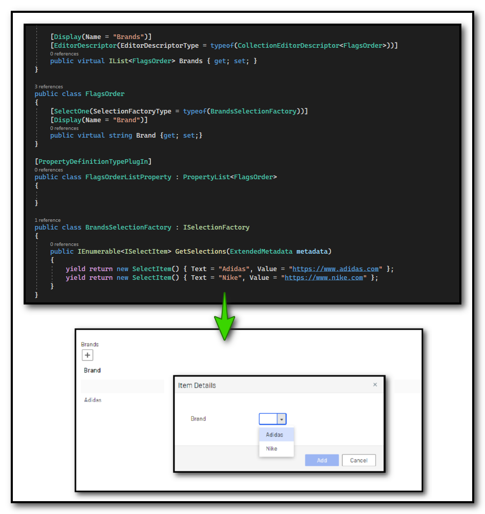

Tomas Hensrud Gulla
I don't really understand exactly what you are trying to do.
A couple examples.
A dropdown list property:
Property list / collections editor:
And them combining them:
#290112
Edited, Oct 16, 2022 4:09
Daniel - Oct 17, 2022 7:38
Thank you very much!!!
This has really helped me a lot.
Tomas Hensrud Gulla - Oct 17, 2022 11:44
Nice, you are welcome 😁
