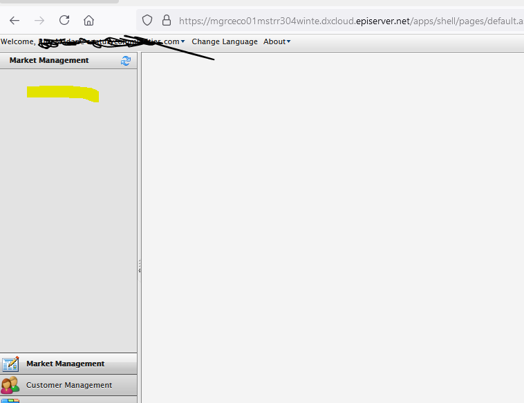

We've setup Commerce manager to work with Azure AD login on DXP environments. We got past login successfully, but got Access Denied screen. We mapped CommerceAdmins role to the WebAdmins role defined in Azure AD and we added CommerceAdmins as a group under Permissions For functions. Now we got past Access Denied screen and can see the Commerce Manager User Interface. The left menu, however, only shows Tabs and no links under it to get to any page :

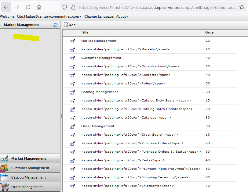

If that doesn't help then try navigate to this link: <yourcommercemanagerroot>/Apps/Shell/Pages/ContentFrame.aspx?_a=Customization&_v=LeftMenuItem-List
That's the left hand admin url that allows you to set permissions for each menu item. See if anything is out of the ordinary there.

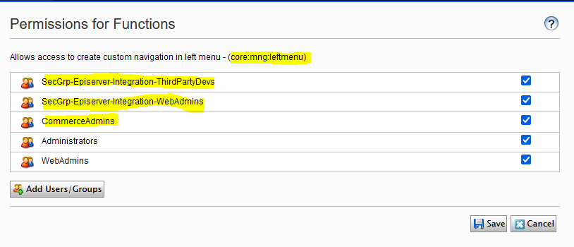

Ritu Madan
Hi Surjit

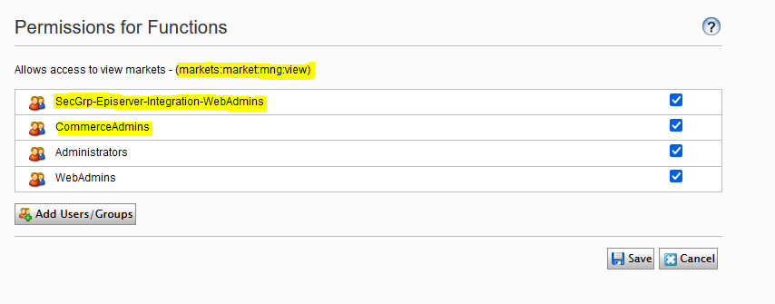

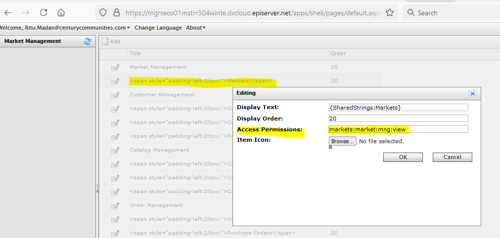

I copied over the Apps folders again from nuget package folder and reviewed permissions on the link you shared. Most of the permissions are already mapped to Commerceadmins role. I even mapped the Azure AD SecGrp-webamin role to these now and restarted the site but still no luck :
So not sure what else is wrong here.
This works fine on my local where Commerce Manager is tied to SQL Login. But not on INTE where its tied to Azure AD login. I'm inclined to assume its because of the access/permissions on the Azure AD roles/groups.
Thoughts?

Ritu, Can you check permissions have been added for the following functions:
  • core:mng:leftmenu
  • markets:tabviewpermission
  • order:tabviewpermission
  • catalog:tabviewpermission

Ritu Madan
Hi Jeroen
Yes the AD roles are setup for both site and Commerce Manager.

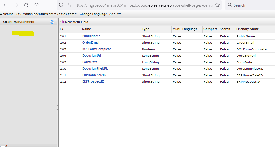

And to answer Surjit's questions above, I did double check all permissions, mapped CommerceAdmins and the AD roles to all that had it missing under Permissions for Functions, redeployed code for commerce Manager, but still no luck. I can access pages, if I type in the URL directly, but don't see left menu links.
Example, I'm at the Order Meta Field page, but no left menu links :
