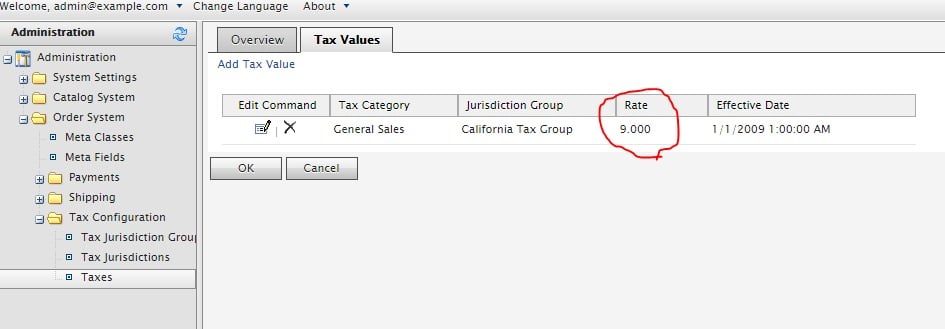

By "getting the tax value", do you mean the values that are configured in Commerce Manager?
For example this one:
In that case you can do something like this:
    var contentLink = _referenceConverter.GetContentLink(lineItem.Code);
    var entryContent = _contentLoader.Get<EntryContentBase>(contentLink);
    var taxCategoryId = (entryContent as IPricing)?.TaxCategoryId;
    if (taxCategoryId.HasValue)
        var taxDto = TaxManager.GetTax(taxCategoryId.Value);
        var percentage = taxDto.TaxValue.FirstOrDefault().Percentage;
In this case I'm getting the only one that is configured in the example above, but you can input whatever you need in the FirstOrDefault argument.
If you need to actually calculate which tax rate is applicable given various parameters (like ITaxCalculator does), then I think Quan already answered. :D
