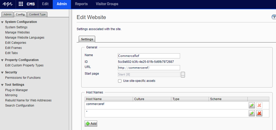

UrlResolver.GetUrl will get the host from the SiteDefinition, so if you set up your site to be http, it will use it. Simply change the setting here

Thanks for the reply. But this is already set as https including all other host names. This was working fine and all of a sudden this issue occured. When we restarted the web app and cache it worked fine and showed https links, but after couple of minutes it reverted back to http for links generated. This is happeninig for all links generated using UrlResolver.GetUrl. Quite strange I know.

Have you specified any scheme in the host settings?
In my example website; I did not specify any scheme in host settings.
Now when I access URL with https all links use with https binding.
when I access URL with http all links use with http binding.
